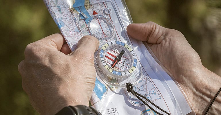

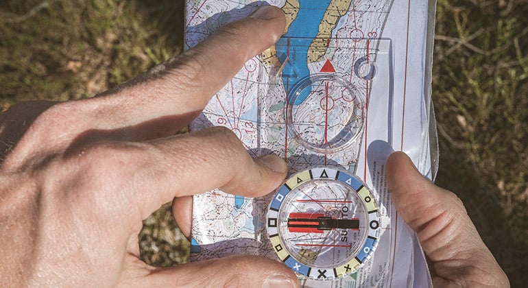

How to get the direction to the next control with a map and a compass?
Place the compass' direction of travel line parallel to the control connecting line on your map. In the image above the line connects the start (marked with a triangle) with the first control (marked with a circle).
Rotate the compass capsule so that the red orienting lines are aligned with the map meridians and pointing north.
Keep the map horizontal while you turn yourself so that the compass north arrow and the map meridians pointing to the north line up. Now the line of travel points towards your next control!

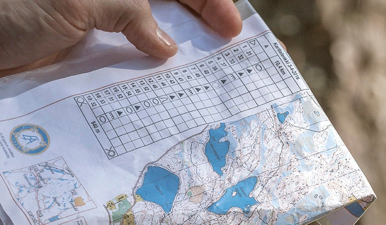

How do you know you are at the right control?
Control description define the exact location of the control (e.g. on the northeast side of the southernmost boulder in the control circle). Code numbers found in the control descriptions reassure you're at the correct control.
