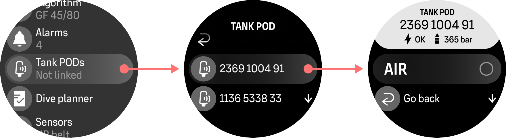

  2. After installing the Tank POD and opening the valve, wait for the green LED on the Tank POD to flash.
  3. Go to the Tank POD menu under Dive options. If your Tank POD is active and in range you see the Tank POD serial number listed.
  4. Select the correct Tank POD and check its battery status and the tank pressure.
  5. Select the correct gas from the list to link with your Suunto Tank POD (if diving with multiple gases).
  6. Make sure the tank size is correct to enable correct gas consumption metering.
  7. Go Back to the main menu and you will see your Tank POD serial number listed under the Tank POD menu.
    tank pod dive options

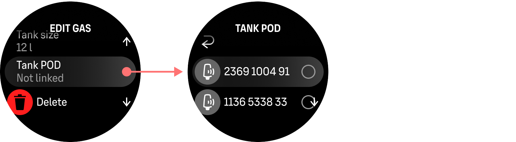

Alternatively, you can link the Suunto Tank POD(s) from the Gases menu:
  1. In the Gases menu, select the gas you want your Tank POD to link with.
  2. Go to the Edit gas view and scroll to the Tank POD setting.
  3. Make sure the Tank POD has been activated and that it is within range. Select your Tank POD serial number from the list.
    tank pod pair gases

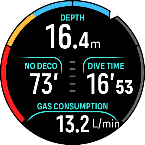

Gas consumption
You can follow your actual gas pressure during your dive from the switch window on the watch screen. You can also see the average gas consumption from the dive in the dive summary in the device and in Suunto app.
The Gas consumption data on the screen refers to your real-time consumption rate of gas during a dive at the depth you are at. To calculate your personal breathing rate, Suunto Ocean uses respiratory minute volume (RMV) which is the volume of gas your lungs experience per minute, measured in L/min or cu ft/min. For accurate gas consumption, you need to define the correct tank size for the gas in the Edit gas menu. See Edit gas. The default tank size is always 12 L (80 cu ft) .
gas consumption screengas consumption summary
