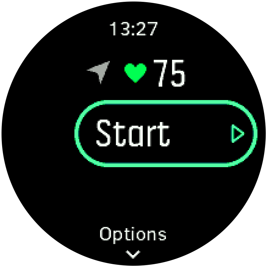

  4. Above the start indicator, a set of icons appear, depending on what you are using with the sport mode (such as heart rate and connected GPS). The arrow icon (connected GPS) flash gray while searching and turn green once a signal is found. The heart icon (heart rate) flash gray while searching and when once a signal is found, it turns into a colored heart attached to a belt if you are using a heart rate sensor or a colored heart without the belt if you are using the optical heart rate sensor.
    If you are using a heart rate sensor but the icon turns to green only (meaning that the optical heart rate sensor is active), check that the heart rate sensor is paired, see Pairing PODs and sensors, and select the sport mode again.
    You can wait for each icon to turn green or start the recording as soon as you like by pressing the middle button.
    Start exercise
    Once the recording is started, the selected heart rate source is locked and cannot be changed during the ongoing training session.

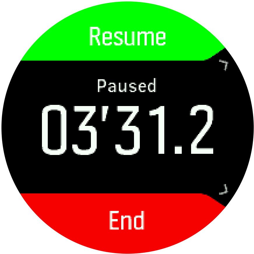

  6. Press the upper right button to pause the recording. Stop and save with the lower right button or resume with the upper right button.
    Recording paused

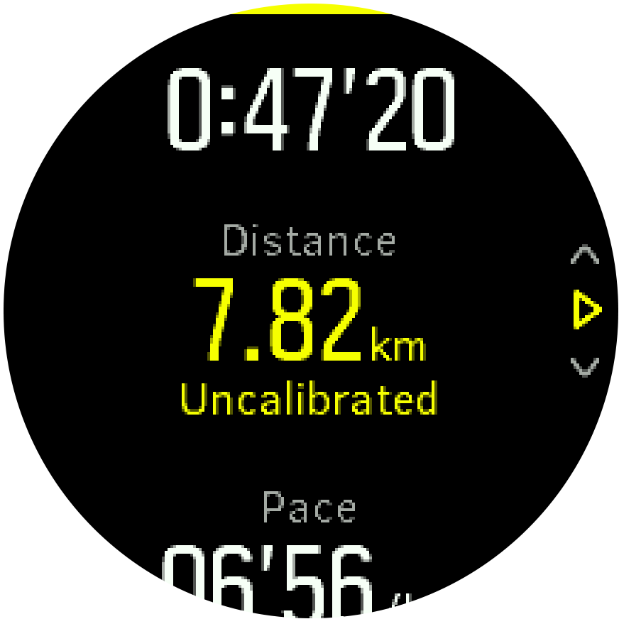

Suunto 3 is able to measure running and walking speed and distance using the built-in accelerometer of the watch. The accelerometer needs to be calibrated to your personal stride length and movement. Uncalibrated, the watch cannot correctly measure speed and distanced.
The easiest way to calibrate your watch is to record the first running or walking exercises with connected GPS (See Connected GPS). When using the GPS of your mobile phone, the speed and distance calibration is done automatically in the background.
To manually calibrate your watch:
  1. Record a walking and running exercise with a known distance (for example on a track) and for at least 12 minutes, see Recording an exercise
  2. Edit the distance after your exercise in the summary by pressing the middle button when the distance is highlighted.
    SF3 Distance Calibration
NOTE:
To get the most accurate result, manually calibrate your watch separately for both running and walking.

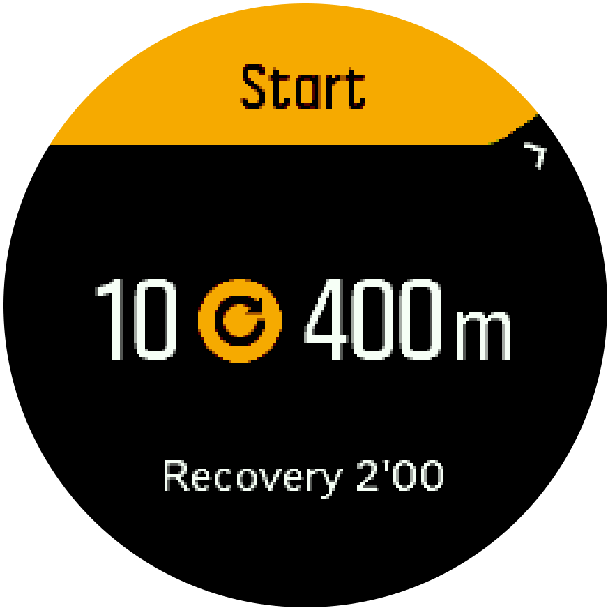

Interval training

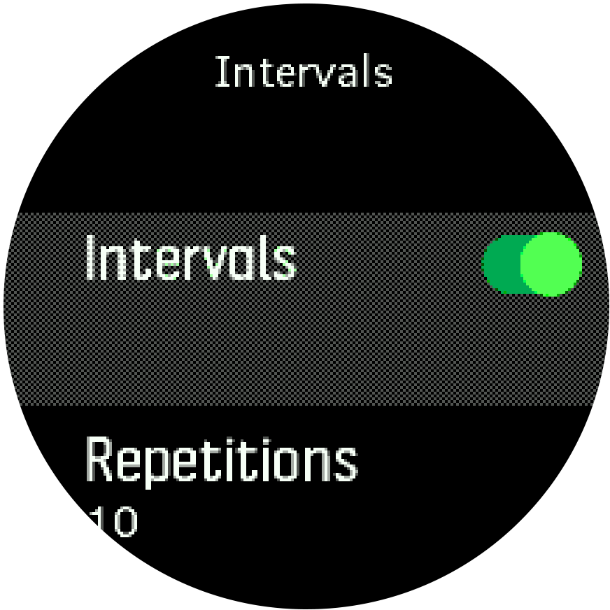

Interval workouts are a common form of training consisting of repetitive sets of high and low intensity efforts. With Suunto 3, you can define your own interval training for each sport mode.
When defining your intervals, you have four items to set:
  • Intervals: on/off toggle that enables interval training. When you toggle this on, an interval training display is added to your sport mode.
  • Repetitions: the number of interval + recovery sets you want to do.
  • Interval: the length of your high intensity interval, based on distance or duration.
  • Recovery: the length of your rest period between intervals, based on distance or duration.
Keep in mind that if you use distance to define your intervals, you need to be in a sport mode that measures distance. The measurement can be based on mobile assisted GPS, wrist based speed or from a foot or bike POD, for example.
To train with intervals:
  1. From the launcher, select your sport.
  2. Before you start an exercise recording, press the lower right button to open the sport mode options.
  3. Scroll down to Intervals and press the middle button.
  4. Toggle intervals on and adjust the settings described above.
  5. Scroll up to Back and confirm with the middle button.
  6. Press the upper right button until you are back at the start view and start your exercise as normal.
  7. Press the lower left button to change the view to intervals display and press the upper right button when you are ready to start your interval training.
    Interval training start Trainer
  8. If you want to stop the interval training before you have completed all your repetitions, keep the middle button pressed to open the sport mode options and toggle off Intervals.

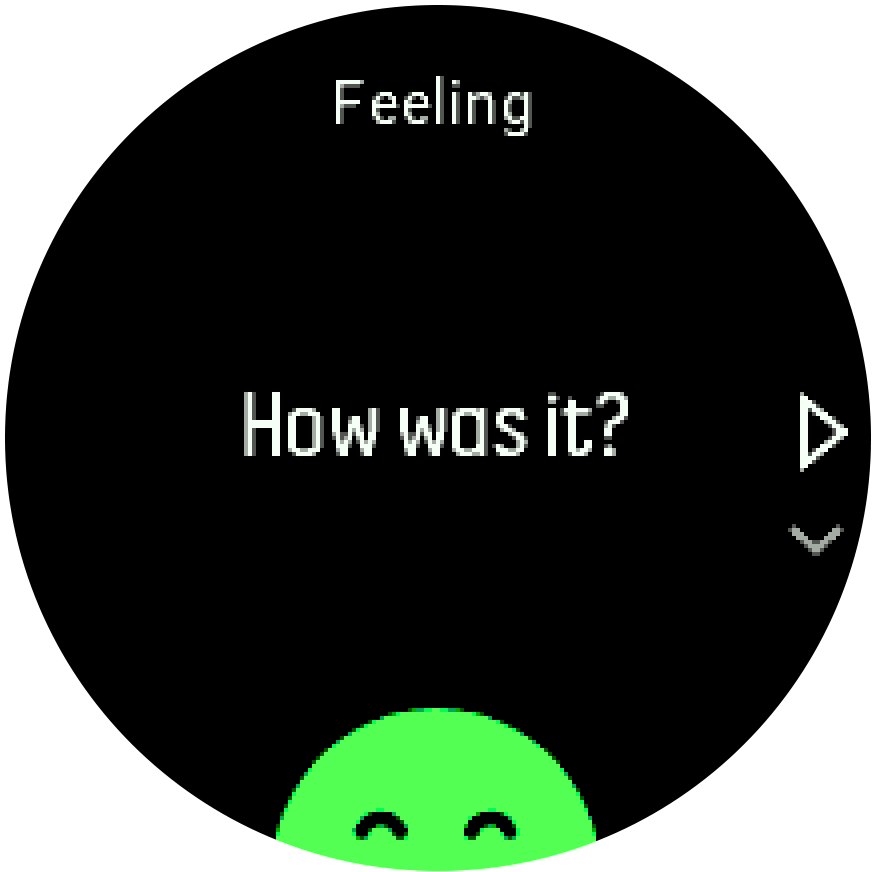

Feeling
If you are training regularly, following how you feel after each session is an important indicator of your overall physical condition.
There are five degrees of feeling to choose from:
  • Poor
  • Average
  • Good
  • Very good
  • Excellent
What these options mean exactly are up to you to decide. The important thing is that you use them consistently.
For each training session, you can record how you felt in the watch directly after stopping the recording by answering the 'How was it?' question.
feeling how was it Trainer
You can skip answering the question by pressing the middle button.

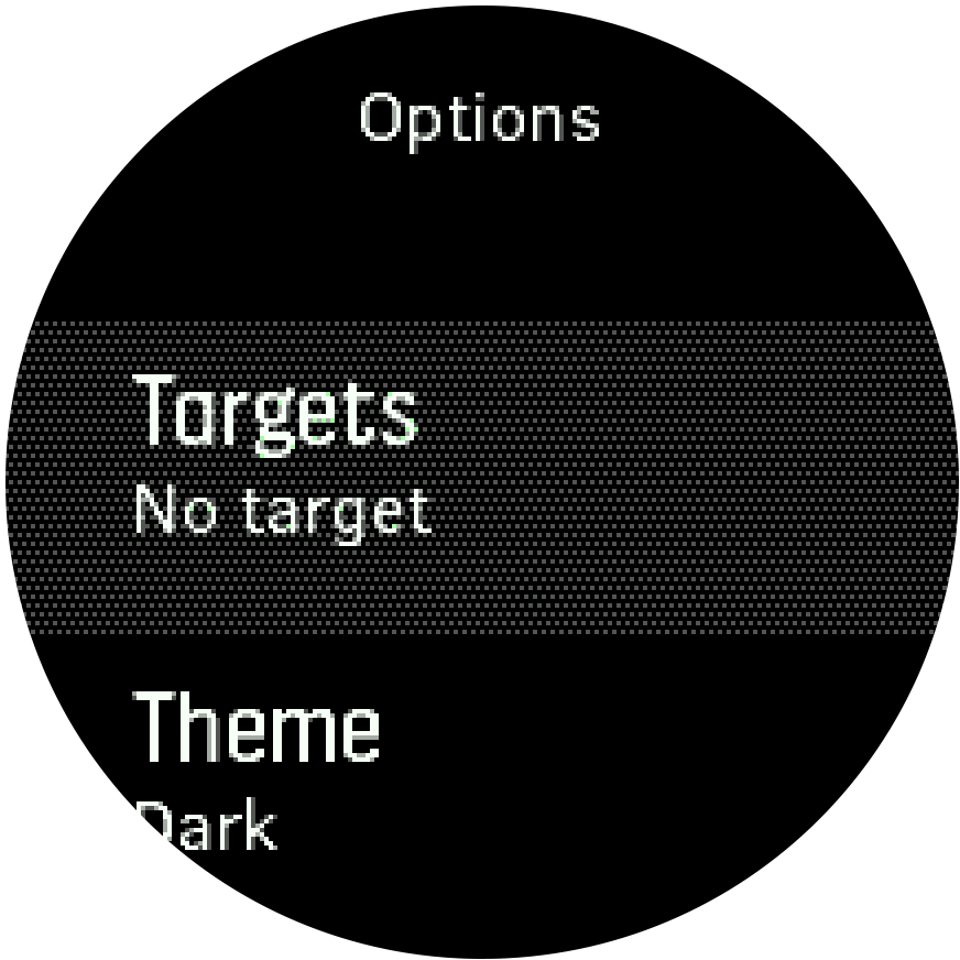

To change display theme in sport mode options:
  1. From the watch face, press the upper right button to scroll to Exercise and press the middle button.
  2. Go to any sport mode and press the lower right button to open the sport mode options.
  3. Scroll down to Theme and press the middle button.
  4. Switch between Light and Dark by pressing the upper right and lower right buttons, and accept with the middle button.
  5. Scroll back up to exit the sport mode options and start (or exit) the sport mode.
