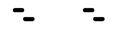

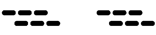

The two audible alarm types indicating high or low priority:
Alarm typeSound patternDuration
High priorityAlarm HighPriority2.4 s sound + 2.4 s break
Low priorityAlarm LowPriority0.8 s sound + 3.2 s break
In addition, there are three audible guidance notifications:
Instructional beepSound patternInterpretation
AscendingAlarm AscendingStart ascending
DescendingAlarm DescendingStart descending
Descending-ascendingAlarm DescendingAscendingChange gas
