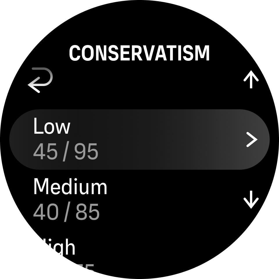

You can adjust the gradient factors. The default conservatism setting in the Suunto Ocean dive computer is set to medium (40/85). You can adjust the setting to more aggressive or more conservative than the default value. Select from the preset levels or set your own custom level.
The preset values are the following:
  • Low: 45/95
  • Medium: 40/85 (default)
  • High: 35/75
For recreational dives, a high conservatism setting (35/75) gives you more buffer to avoid decompression requirements. Low conservatism setting (45/95) gives you more NDL time but also a lower buffer so it is a more aggressive setting.
GFsettingsNEW
