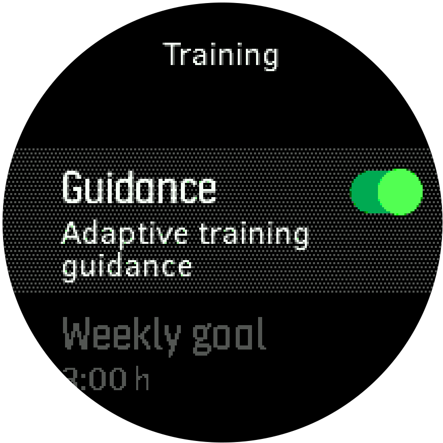

To disable your personalized training plan:
  1. Under the settings menu, go to Training.
  2. Toggle the Guidance to off.
    SF3 Guidance

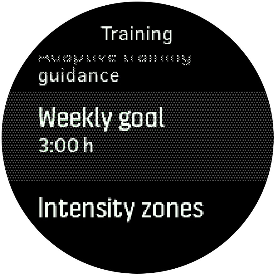

If you don't want the adaptive guidance but would like an exercise goal, you can define a target number of hours as your weekly goal from the settings under Training.
  1. Disable Guidance.
  2. Select Weekly goal. by pressing the middle button.
  3. Select your new Weekly goal by pressing the upper right or lower right buttons.
    SF3 Weekly Goal
  4. Confirm by pressing the middle button.
